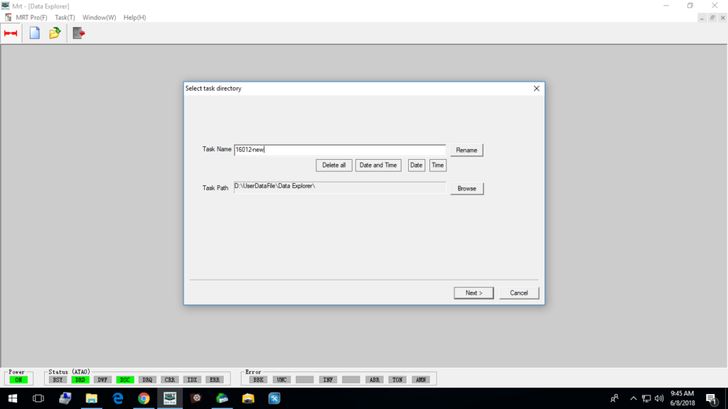

Step 1 – Create a new task with a different task name than the original task. Be sure to use the same settings as the original task.
Step 2 – Close the new DE task

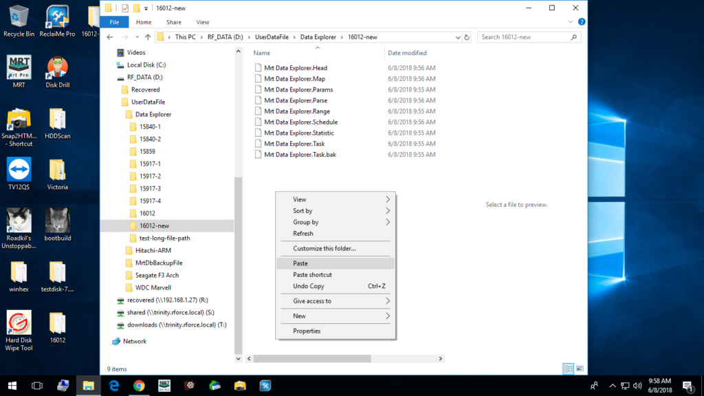

Step 3 – Copy the file, “Mrt Data Explorer.Map” file from the old task folder to the newly created task folder, allowing Windows to overwrite the file.
Step 4 – Re-Open the newly created task in DE
