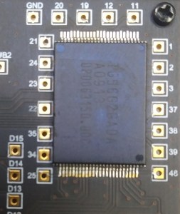

When we removed the NAND chip and took a closer look, we discovered that it actually has 56 pins, like a TSOP56 chip, but the 8 outer pins were cut off, allowing it to interface with the TSOP48 connectors on the USB thumb drive.  However, when we tried to interface the chip as a TSOP48, it would not fit in our TSOP48 reader because it was too wide, yet it was too long to fit in a TSOP56 reader.

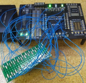

We went so far as to connect it to a TSOP48 spot on our power board, but although it looked right, the pinout wasn’t even close to matching, which left us scrambling to come up with a custom solution.
We ended up soldering the TSOP56 NAND chip to a basic TSOP48 board which would allow us to more easily manually wire each pin to the appropriate channel on our circuit board, allowing us to finally interface with the two channel NAND chip.  Special thanks to Colonel Chappy on the Flash Extractor forum for posting a pinout.
