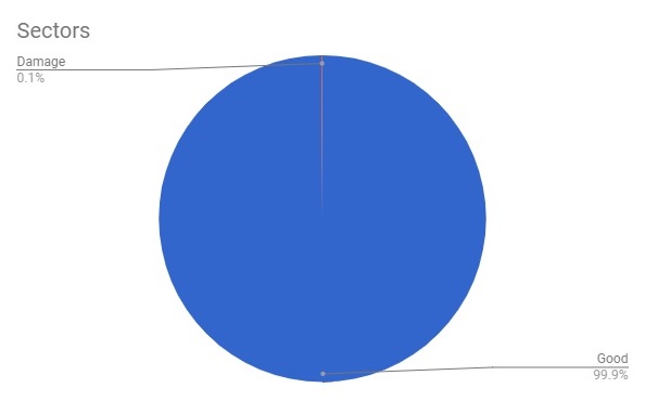

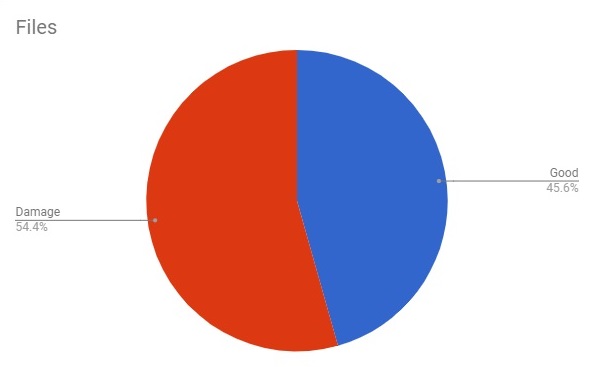

In a current case where we changed the read/write heads several weeks ago, we have read 99.91% of the sectors and only have 45.6% of the files being healthy.  It is probable that we aren’t going to see the major jump in percentage of good healthy readable files this time, but we will continue to push and try to get every sector possible read from the damaged hard drive.
