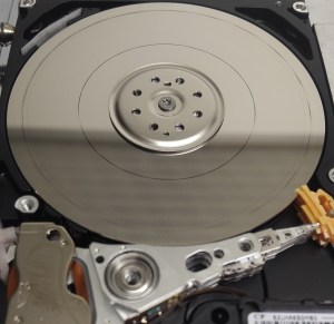

In this case, we have a hard drive that was dropped and is clicking.  We diagnosed that the heads were crashing and needed to be replaced.  After replacing the heads, we were able to get the drive to detect and read.  Using our hardware imager, we were able to focus our drive imaging process on the sectors which contain data, avoiding areas with a lot of damage for the first pass and gradually worked a little harder on the damaged areas.  Unfortunately, the drive breathed its last before we could get a 100% read of the data.  However, we were very fortunate to get 93% of the data recovered from this client’s dropped hard drive.
