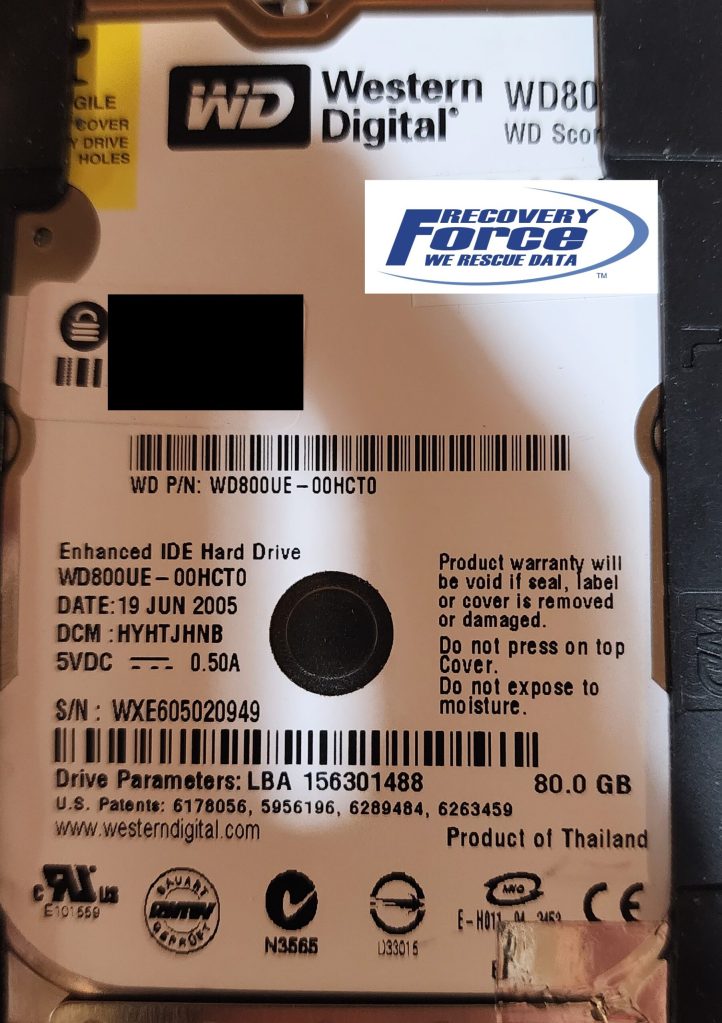

Upon receiving the customer’s drive, we did a quick visual assessment to confirm that the seals were not broken and that the drive has not been opened. We then proceeded to connect the drive to our recovery system where we quickly backed up the firmware and started the process to image the drive.
All four read/write heads appeared to be reading, but very slowly compared to the speeds we would expect for a heallthy drive. We were able to get a full clone of the drive, with about a couple dozen unreadable damaged sectors. This made it clear to us why Windows was having issues accessing the data on the drive and what prompted it to run chkdsk.
Now, as for the file system damage caused by chkdsk, some files were already named to a system generated file name in a folder called Found.000; however, after running a full scan with our file sytem recovery software, we were able to reconstruct most of the original file structure, with a few system genrated folder names.
Because the drive didn’t even need to be opened up in our clean room or have any advanced data recovery procedures like firmware repair, we were able to complete the recovery and have it ready to ship back to the customer within 24 hours of receiving it at our base rate of 500CAD, which is about 375USD at the time of writing this article.
