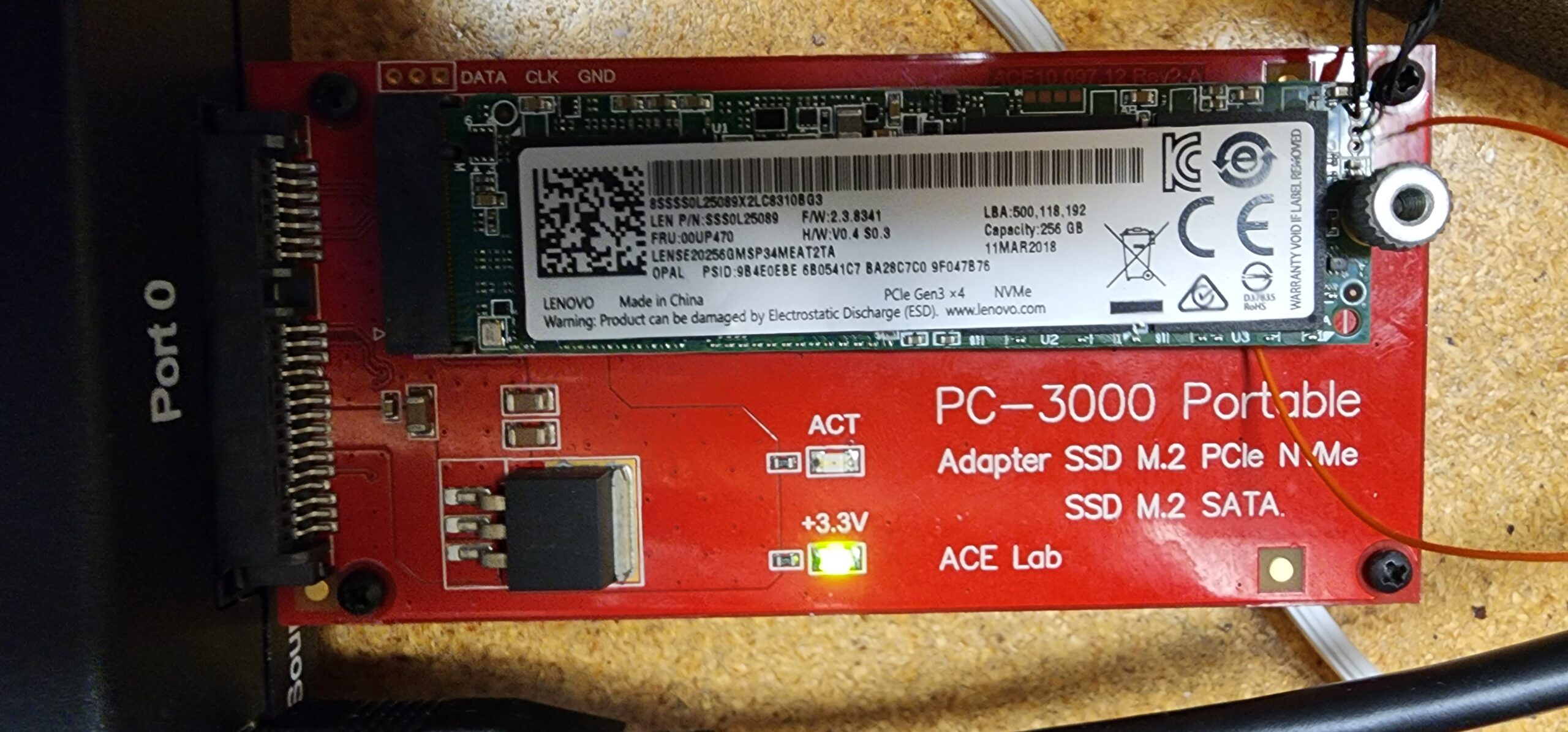

I just received the NVMe SSD freshly formatted yesterday morning by the tech attempting the recovery. The end result, the SSD is full of emtpy (0x00) sectors, thanks to the TRIM process and now it is impossible to recover any data at this point. Rule #1 in data recovery is to never write data to or format the drive from which you are trying to recover data.
