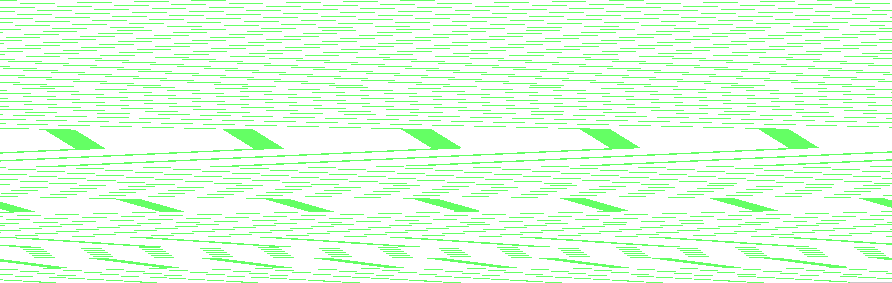

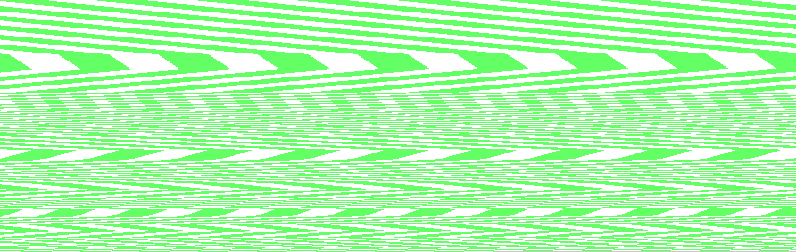

The image below represents a Western Digital WD800JD-00JRA0 with 2 heads.
WD800JD-00JRA0 head map of 2 heads
The green represents head 0, while the white represents head 1.

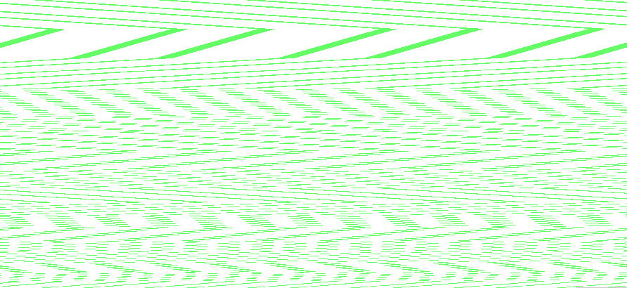

Below are images, each showing a different head from a Seagate ST3750330AS hard drive with 6 heads.
ST3750330AS - 1st of 6 heads
The image above shows the 1st of 6 heads, showing in green.

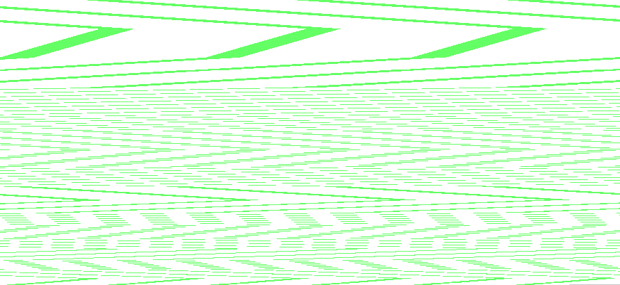

ST3750330AS - 2nd of 6 heads
The image above shows the 2nd of 6 heads, showing in green.

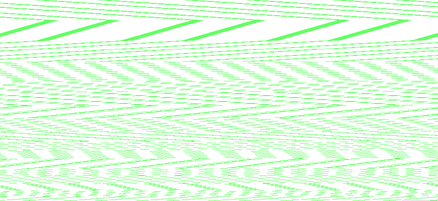

ST3750330AS- H2
The image above shows the 3rd of 6 heads, showing in green.

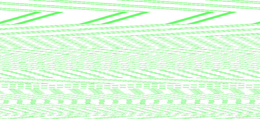

ST3750330AS- H3
The image above shows the 4th of 6 heads, showing in green.

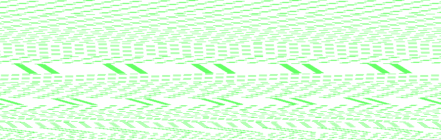

ST3750330AS- H4
The image above shows the 5th of 6 heads, showing in green.
