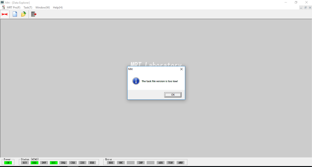

What is the problem?
When a user chooses to open a task in DE, they are prompted with the error message, “The task file version is too low!”  This is particularly frustrating for a user working on a project with a drive that is unstable and may not image the same sectors a second time, assuming that the patient drive is even still working.

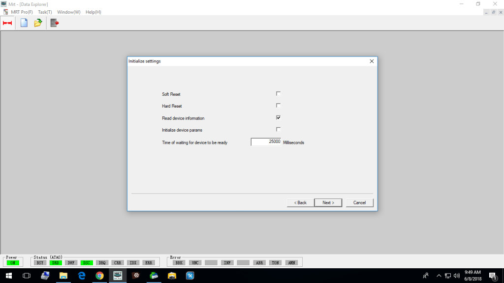

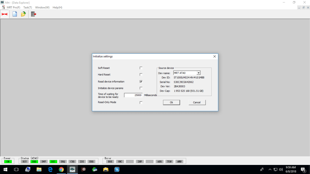

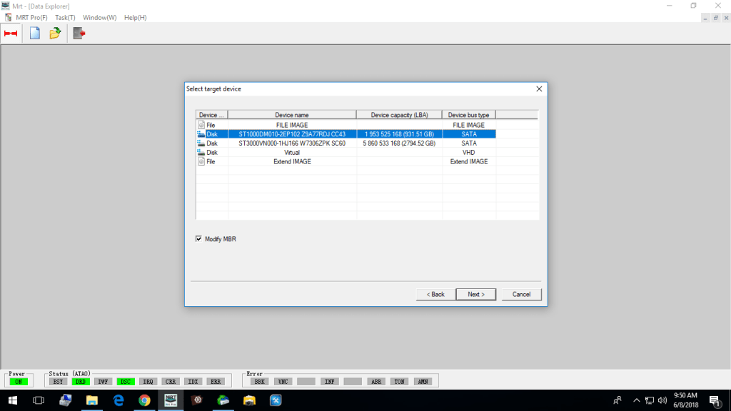

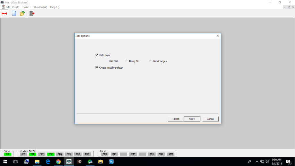

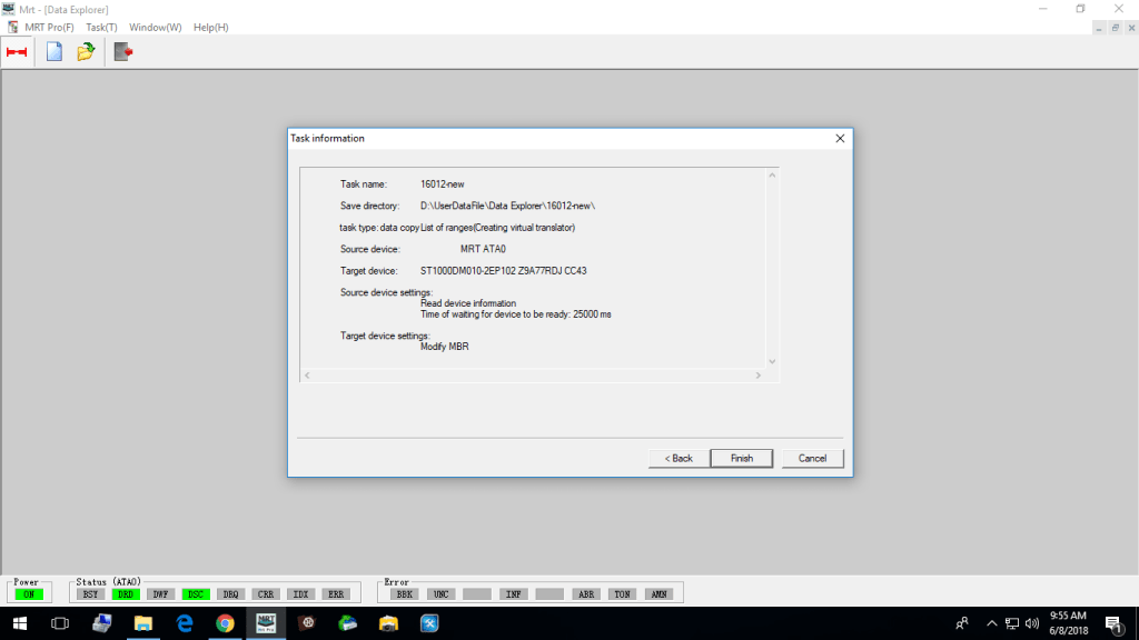

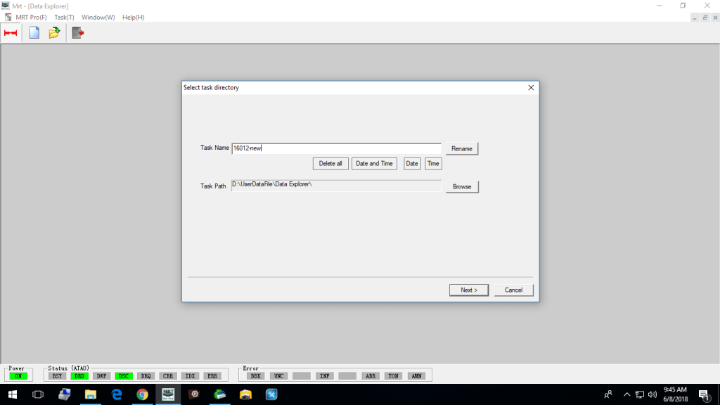

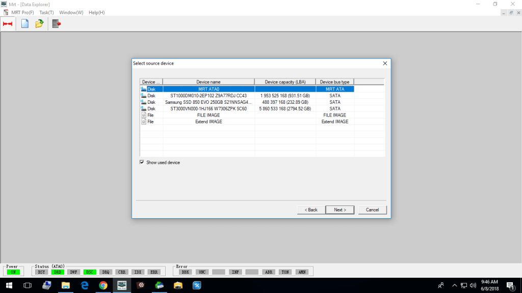

Step 1 – Create a new task with a different task name than the original task.  Be sure to use the same settings as the original task.
Step 2 – Close the new DE task

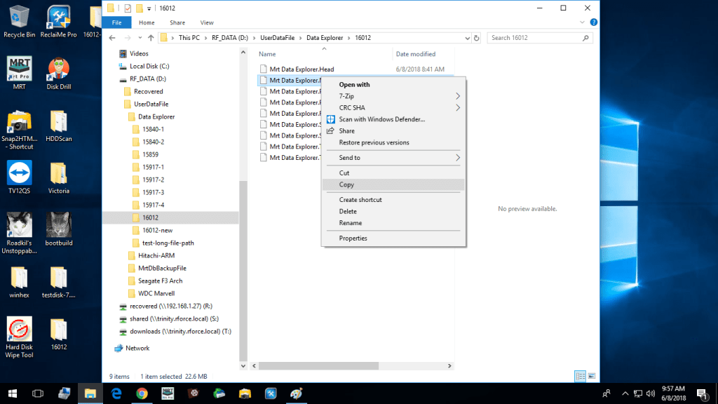

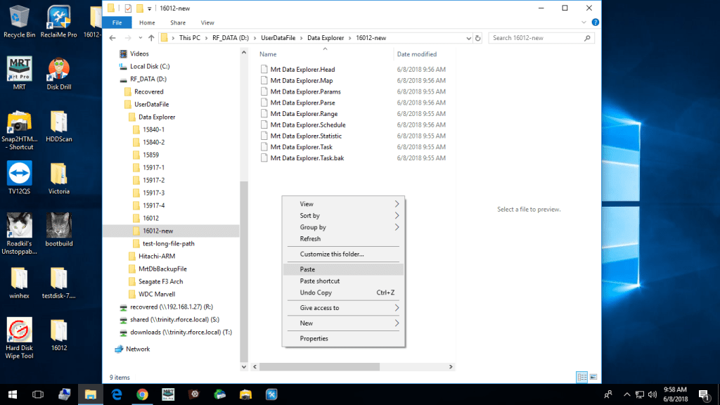

Step 3 – Copy the file, “Mrt Data Explorer.Map” file from the old task folder to the newly created task folder, allowing Windows to overwrite the file.

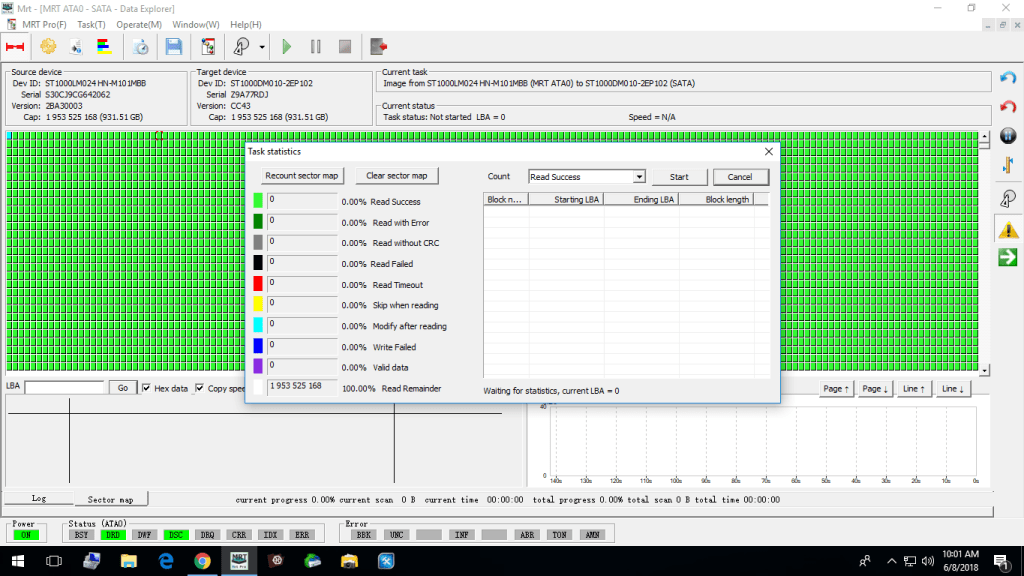

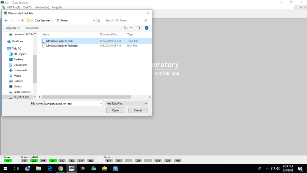

Step 4 – Re-Open the newly created task in DE
Step 5 – Re-calculate the sector map

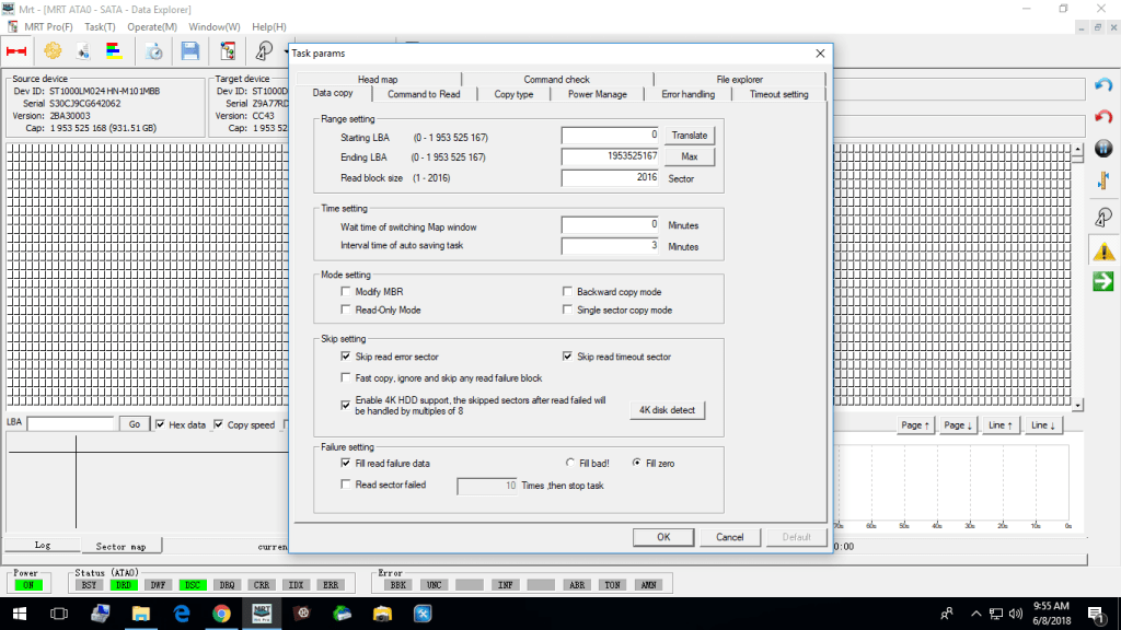

Step 6 – Re-configure the task parameters to your preferred settings and carry on with your data recovery project.
