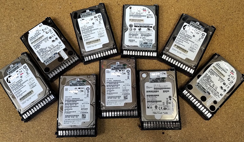

  • The original RAID was 5 x 300 GB SAS hard drives in a RAID 5 with 1 hot spare
  • 3 drives reportedly failed
  • The 3 failed drives were replaced with 3 new drives
  • The RAID was rebuilt with the original configuration
  • Backup data was restored to the new RAID array with 3 of the 6 original drives being used
  • It was quickly discovered that the VM files with the most critical MSSQL files were not in the backup after it was restored onto the new array
We figured that, between the RAID rebuild with three blank drives and the restore of the backup, most of the data, if not all of it, would have been completely destroyed; but that didn’t stop us from giving it a try.
The Recovery Process
After cloning all 6 original drives, we discovered that, of the 3 damaged drives, the HP technician who was sent on site to replace the failed drives, only swapped 1 correct drive. He then took 2 good drives with him and left behind the 2 drives with bad sectors. This would likely lead to another crash in the near future.
We then determined which of the 2 original 6 drives were virtually the same.  One was the hot spare that kicked in and rebuilt the drive.
Then, in order to rebuild the RAID, we needed the 3 replaced drives and 2 of the partially overwritten originals.  It is from here that we expected a huge fight trying to find and recover the VMDK file which held the required MSSQL.  Fortunately, we got a bit of a break, as our tools very quickly were able to rebuild the original NTFS file tree.
Once we had the file tree, we were able to find the VMDK and recover the files from within.  But, things weren’t done yet.   The recovered MSSQL file was still affected by partial overwriting and missing data blocks.  We were able to grab a backup file that was also stored within the VM and our client was able to rebuild and repair the file to a point where they could get their client back online.
