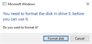

A very common symptom of a failing hard drive is for Windows to pop up with a message saying, “You need to format the disk in drive E: before you can use it.”  From the perspective of Windows, this message is brought up for a couple of reasons:

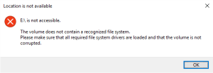

The File Table is Damaged or Missing
NotAccessibleThe file table is like a table of contents giving details about the files and folders such as their names, folder structure and where they are located on the drive.  If Windows is unable to fully read through the MFT, it will fail to load the file structure and pop up a message that the drive needs to be formatted.

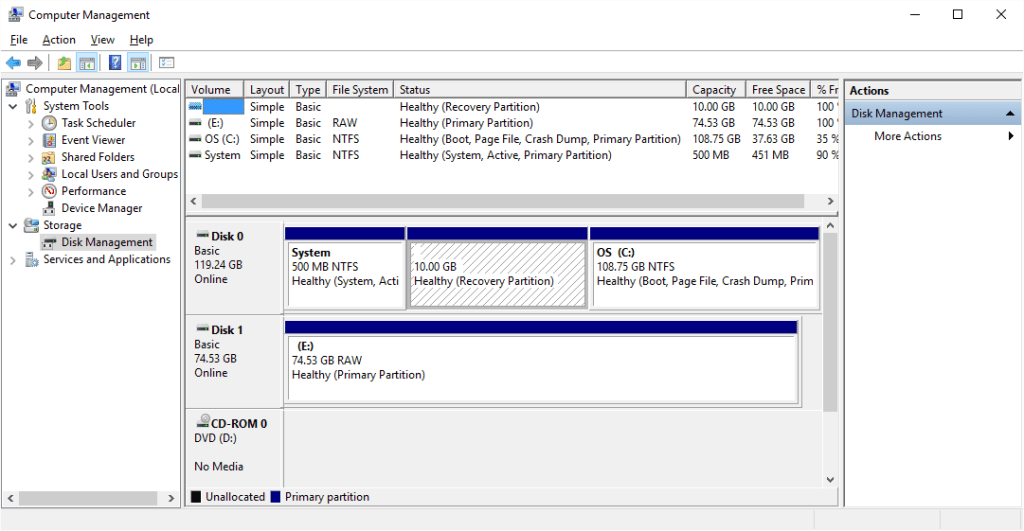

This is the key question that should be asked before trying to deal with the issues.  We can appreciate that it seems to make sense to try and recreate the missing boot sector or to run a file system check to repair the file table, but neither of these actions will correct the root cause of the damage and will likely just result in unnecessary data loss.
The typical reasons for these symptoms are due to bad sectors, firmware issues, failing PCB and/or failing heads.  It is critical that the correct course of action is taken, based on the root cause, as follows:
Bad sectors: get a full sector-by-sector clone/image of the drive and then attempt file system repair/recovery on the stable copy.
Firmware issues: this usually requires professional data recovery equipment to fix the offending firmware modules and then get a full sector-by-sector clone/image of the drive and then attempt a file system repair/recovery on the stable copy.
Failing PCB: fix or replace the damaged circuit board.  The circuit board usually has unique data stored on it and almost always needs that information transferred to the donor board in order for it to be compatible with the patient drive. Then get a full sector-by-sector clone/image of the drive and then attempt a file system repair/recovery on the stable copy.
Failing heads: in most cases, bad heads means that the drive will not even identify to the computer and usually involves bad sounding noises.  However, it is not uncommon for drives to have heads that work enough to look like they are healthy, but not enough to properly read the data from the platter surfaces.  Damaged heads are usually accompanied with bad sectors, so again, it is important to get a full sector-by-sector clone/image of the drive after the heads are replaced with a healthy set. And, again, attempt a file system repair/recovery on the stable copy.
