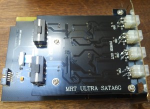

MRT Ultra 4 SATA Port / 1 PATA Port Card

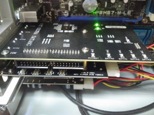

PC3000 Express 4 SATA Port / 2 PATA Port Card

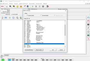

The software interface is, again, quite familiar to PC3000 with how each brand and series of drive access its brand specific utility.  The menus and wording are quite different, and somewhat confusing at times.  But, overall, the familiar interface helps speed up the learning curve for those who are already accustomed to PC3000.
MRT’s DE (Data Explorer) is similar to PC3000’s DE (Data Extractor), but they do approach things quite differently.  Data Explorer has a long way to go to compete with Data Extractor as it still only support NTFS and FAT based file systems.  But, if you aren’t concerned about targeting the used sectors by the file system within the imaging facility, it is more than capable of getting a full sector-by-sector image of your failing hard drive.

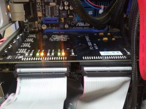

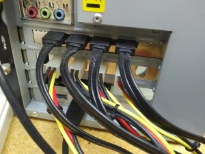

MRT Ultra 4 SATA Port / 1 PATA Port Rear Connectors

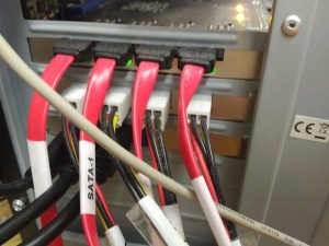

PC3000 Express 4 SATA Port / 1 PATA Port Rear Connectors
