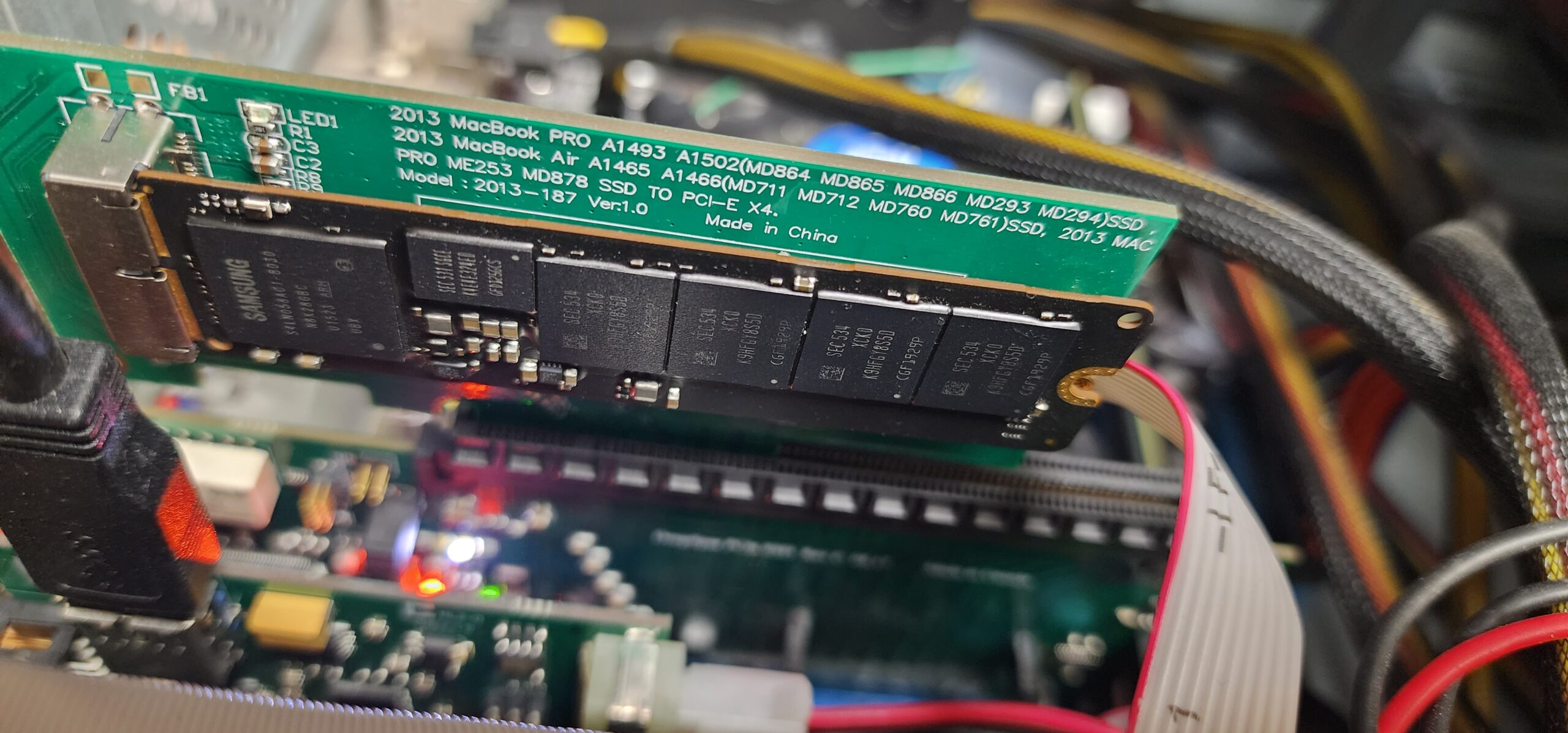

Since making these investements, we have been able to get unresponsive SSDs from Apple MacBooks recovered, using the DeepSpar PCIe add-on.

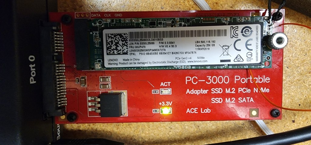

With PC3000 Portable III, we have been able to fully recover unresponsive NVMe SSDs with failing NAND and corrupt firmware, such as a Lenovo LENSE20256MSP34MEAT2TA with an 88SS1093 controller.

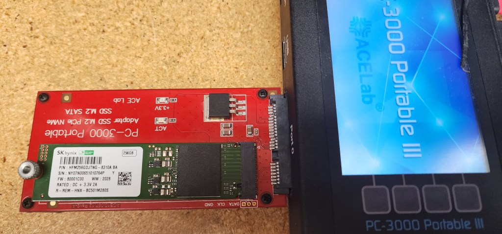

Also with PC3000 Portable III, we have been able to recover NVMe SSDs that get stuck in an unresponsive BSY state within a fraction of a second of being powered on, such as this SK hynix HFM256GDJTNG-8310 BA NVMe SSD that shows as dead and unresponsive on most systems.

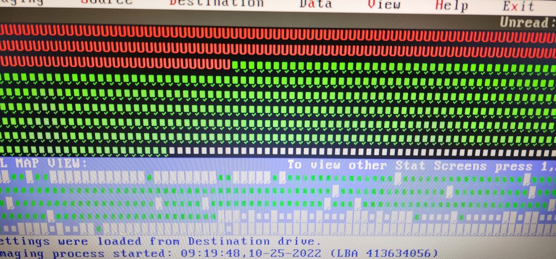

Sometimes we are able to get the SSD to a point where it is able to load the necessary firmware and give access to the data sectors, but the NAND is very degraded where we are getting anywhere from 25 to 90% read errors. In such cases, we may need to apply heat or cooling to the NAND chips and go so far as to re-read sectors hundreds of times before we are able to get good data read. In such cases, we can get such slow read speeds that it can take us weeks, months or even years to recover the targeted data which is made worse with the inclusion of an extra layer of file system encryption, requiring us to get a full image of the entire SSD.
