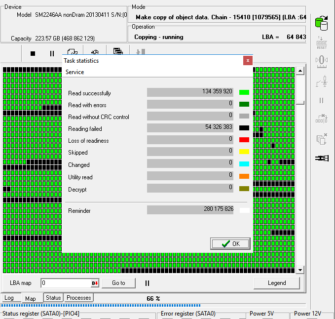

Sadly, in most cases we have encountered, we are lucky to read 30-40% of the sectors without errors, leaving us with 60-70% of the sectors unreadable, somewhat like the image below with about 24% read on the first pass.
After a month of re-reading and banging away at the bad zones on this SSD, we have made huge strides to getting the percentage of readable sectors up to about 71%.
Sadly, this does not equate to 71% of the files being readable.  At this stage of the game, it is more like 1% of the files without any damaged sectors.  We currently have our read retries set to re-read each unreadable sector 100 times before moving onto the next sector.  With each pass, which takes more than a week to complete, we read more sectors, but less than the pass before.

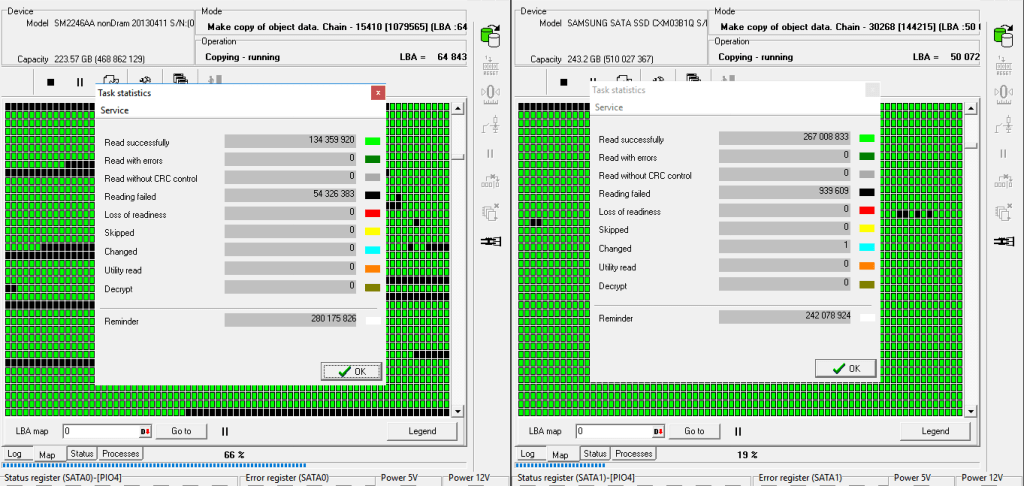

To help put things in perspective, here is a side-by-side of the SanDisk SSD Plus after running for over a month and a Samsung 830 series SSD with similar issues, but better results of more than 99% of the sectors being read.
Even with the Samsung having read more than 99% of the sectors within the files, we currently only have 95% of those files without errors.  Again, with 100 read-retries, we forge forward in hopes to get our clients the best recovery results possible.
