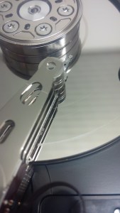

Seagate 7200.12 Head CrashAs we get close to the end of 2015, we have been noticing a trend with Seagate 7200.12 series drives coming in for recovery.  Many are coming from older Apple iMac systems, but others are coming from external hard drive enclosures and other brand name computers.
Normally, we receive a high percentage of drives before the final head crash, but with these drives, they are arriving with the client describing them as clicking.
When we open the drives in our clean room, we are finding varying degrees of fatal head crashes.  Some worse than others, but almost all unrecoverable with a very dirty filter holding most of the user’s data.

If you are using a system that contains a Seagate 7200.12 series drive, we advise that you verify that you have a solid backup in place, should the drive fail and test the drive frequently for warning signs of failure.  Of course, we recommend this for all hard drives, even those just recently purchased.Seagate 7200.12 Filter from Head Crash
