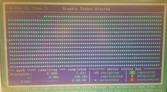

So, my test case is a 500GB Seagate 2.5″ Momentus that has an unreadable sector on it.  To start, I used DeepSpar Disk Imager to get a full clone of the drive.  The process took about 2 hours and mirrored all but 1 sector that it could not read.  I then ran SpinRite against that same drive and after running the default fast scan and repair for about 4 hours, it completed with no suggestion that it even encounter a read error, let alone fixed anything.
SpinRiteComplete
SpinRite Process Completed. No errors reported or sectors remapped.

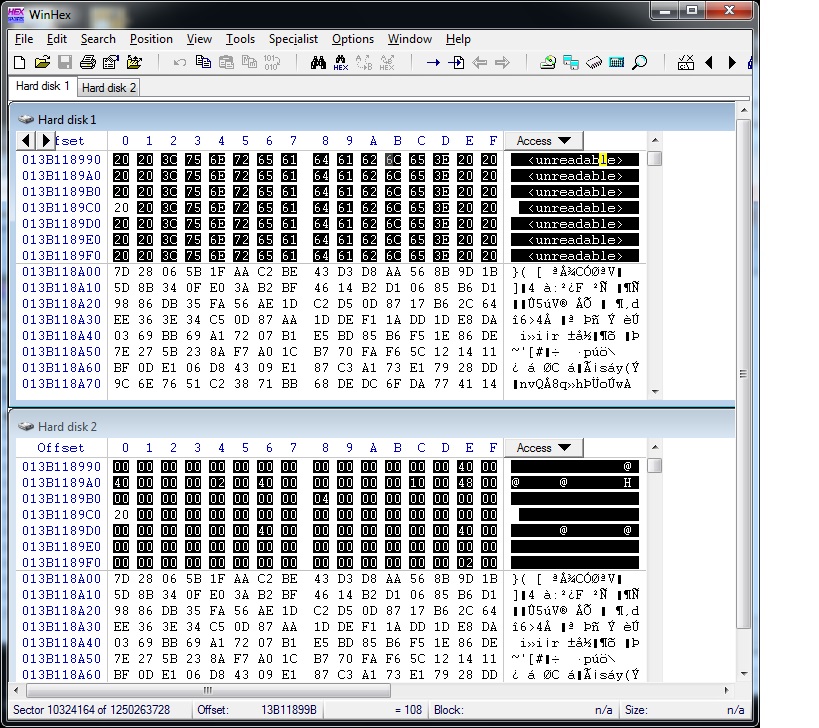

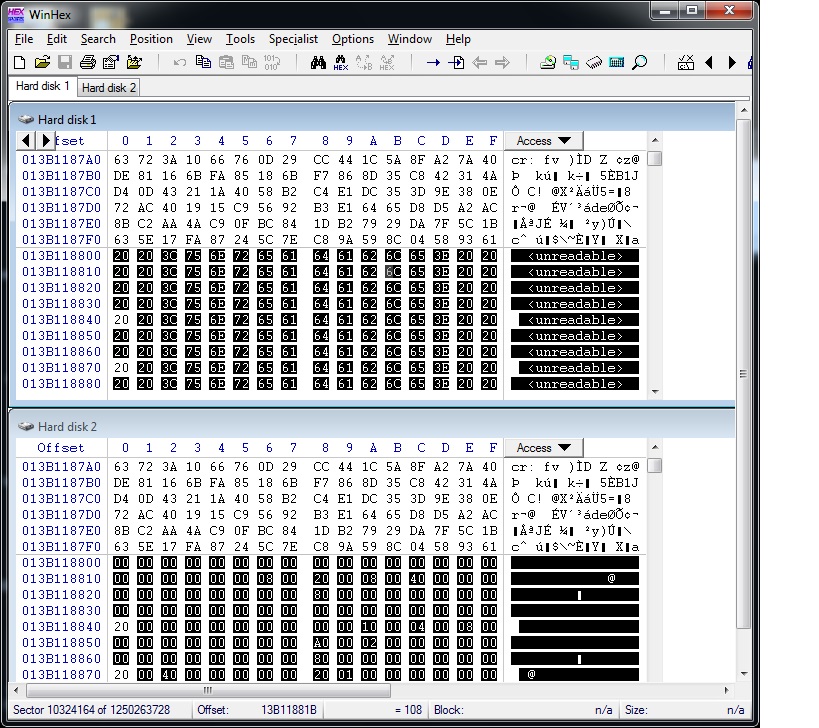

So, after the process was completed, I then proceeded to compare the two hard drives, focusing on the one sector that I knew was unreadable with DeepSpar Disk Imager.
Data in remapped sector does not fit with the preceding sector data.
Data in remapped sector does not fit with the proceeding sector data.
The previous two screen captures show that SpinRite “fixed” the sector that was unreadable by DeepSpar Disk Imager by overwriting it with irrelevant data, even though it did not even report that a read error was encountered or repaired.
