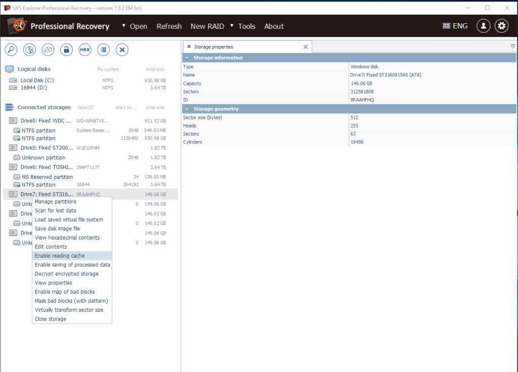

For example, G-RAID external storage units are known to use a block size of 1 sector. Because of this, the rotation between drives is so frequent, it causes the recovery software to come to a crawl.  But, with the help of enabling the reading cache for each of the drive members from the RAID array and then building the RAID array with the cache-enabled versions of the drives, things speed up exponentially.   This can be seen in the screen captures below.
Select
Select “Enable reading cache”

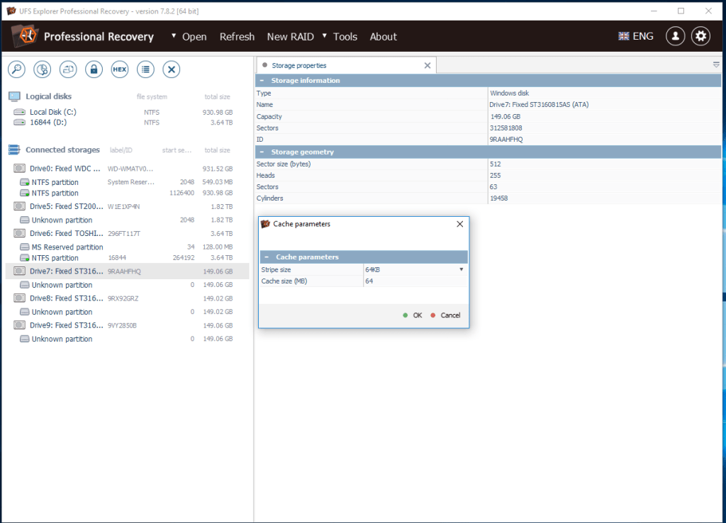

Reading cache properties.

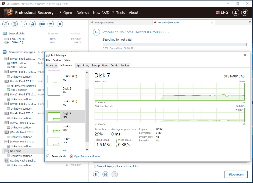

Scanning RAID-5 without reading cache with read speeds about 1.6MBps

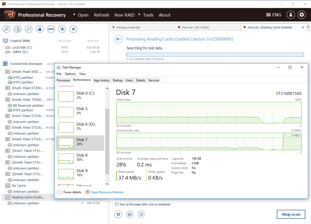

Scanning RAID-5 with reading cache with read speeds about 37.4MBps
With a jump from 1.6MBps to 37.4MBps, that is more than 23 times faster.   If one were recovering from a very small RAID array, the speed and time for the recovery may not be of any concern.  But, when we are encountering RAIDs with 4TB RAID members, this very feature turns a month into a day, which is essential when providing data recovery services to business clients who need their data recovered as soon as possible.
